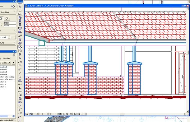

Just working on a situation where the original idea of fill patterns staying as fills would not work (easily). I have a facetted roof with a shingle fill associated with the material. As the facets become more oblique to the view the fill pattern changes to follow the slope. I think the best that could be offered here would be grouped lines as each section of roof is different.
Sorry to throw cold water on your idea, Joeri.
The "adjusted" fill patterns are valuable on sloped roofs. Version 10 has a "distorted fill" that will accommodate this wish.
