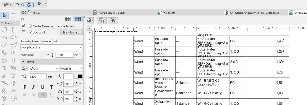

Archicad schedule cells adjust to text
Is it possible to set Archicad Schedules in a way that the cells extend automaticly, so that the text is readable?
I can do it manually, but the schedule is long.
Thank you!

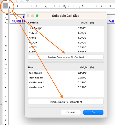

Eduardo Rolon
Like this?

ananas
Yes, perfect thank you!
