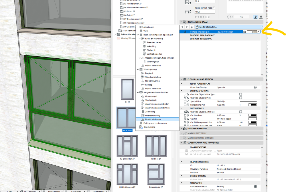

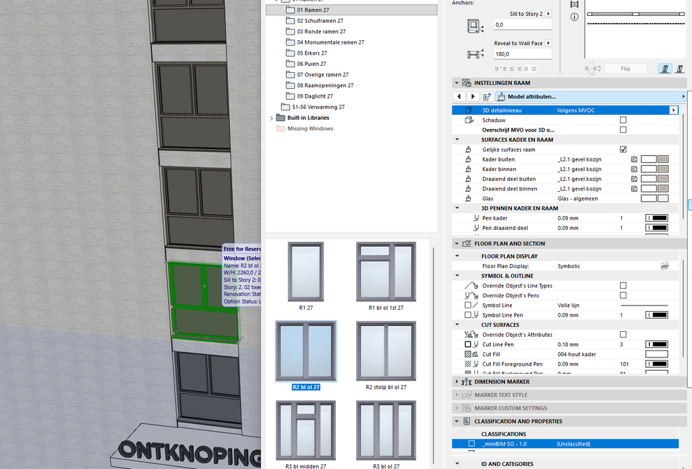

In our Source file the window uses a surface named _L2.1 gevel kozijn for all windows components: Frame, Turning part en Surface Sill
Screenshots Source model surfaces:

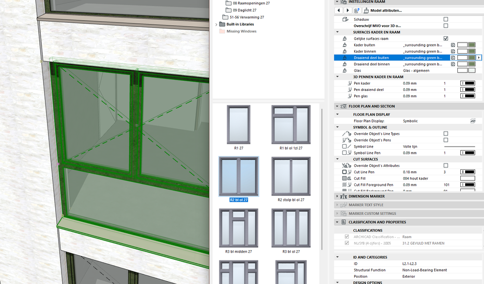

However in our Main Model the surface suddenly is switched to _Surrounding green buffer, but only the Frame and the rotating part . The Surface of the Sill has remained the same _L2.1 gevel kozijn
Screenshots Host model ( Main Model) surfaces :
You can see that the window has the grass surface^

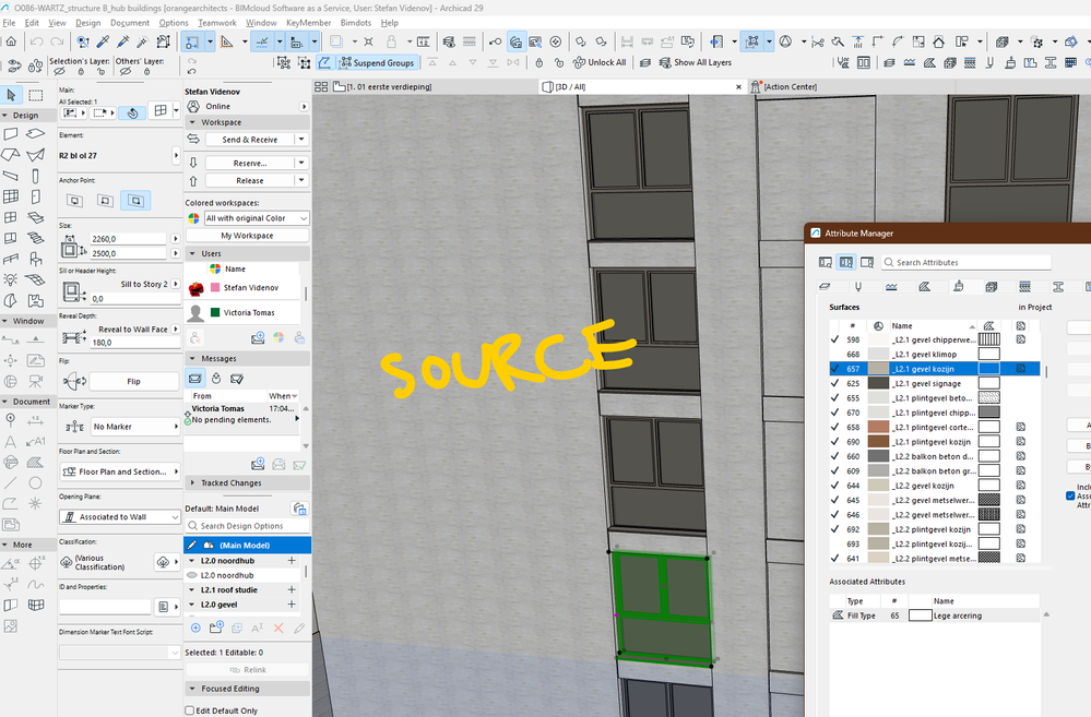

Index of the  _L2.1 gevel kozijn surface is 657 in the source:

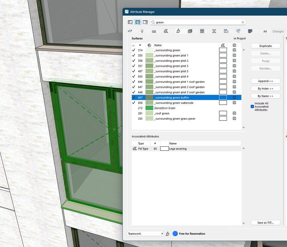

In the target file _surrounding green buffer has the same index.
Obviously, In MainModel Archicad has started pulling the index of the Surface instead of the Name, but I do not think that is normal behavior.

    • Collision — different names sharing the same index between files (your case: _L2.1 gevel kozijn ↔ _Surrounding green buffer both at 657)
    • Displaced — same name sitting at different indexes
    • Partial — an attribute missing in some files
  3. For each conflict you pick an action: keep, fill the gaps, consolidate to a shared free index (600+), realign onto an existing free index, or mark for deletion.
Then you export the corrected XMLs back
  • Each file is exported with the old conflicting attribute renamed using a 0001 A supprimer / remplacer suffix.
  • In Archicad's Attribute Manager you append by index, then use Delete & Replace to swap the old attribute for the new one — so your placed elements keep their settings instead of silently picking up another surface.
For your exact situation you'd immediately see that index 657 holds two different surfaces, and you'd move _L2.1 gevel kozijn to a free slot so both files finally agree — which is precisely the "reindexing" you said you're starting to do, but done in a controlled, side-by-side way.
