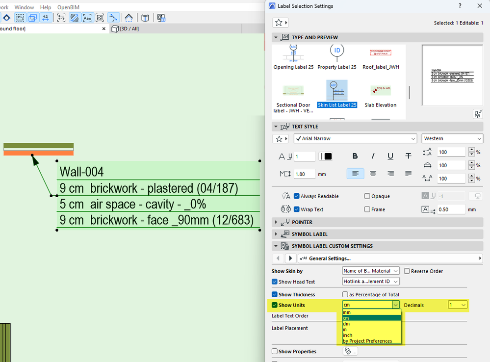

Can you help me to configure an expression to have the information as the attach picture. I guess is a simply one, is just to have meters in "cm" or "mm" and only with two decimal houses.
The solution using Calculation Units in the Options > Project Preferences > Calculation Units & Rules Dialog, doesn’t work for me because I do not want the schedules to use centimeter.
Thanks for your time to read my issue

@Xavi wrote:
Graphisoft should improve the label skin, so could read any element and with the option to choose which decimal and units we want. 🙂
You can't pick and choose which skin to label, but you can change the units and decimal precision.
Go to post

Xavi
Thank you  Xandros and Barry, for the quick reply.
Did work perfectly. I appreciate the help.
Xavi
Yes am using that label, but this one works for compositing elements and not for complex profile for example (doesn't read the thickness, and skins).
So at the moment I am using Label skins for compositing elements (walls, slabs etc..)
and for complex profile i use auto text, extracting the information from the "Profile modifiers".
Is working but, would be great to have just one tool to do this two operations.
At the moment I have another issue, because I would like to save this label as "2D Elements Label with auto text" but doesn't work.
If you could take a look att the link I would appreciate.
https://community.graphisoft.com/t5/Archicad-C-API/Save-2D-Elements-as-Label-auto-text-empty/m-p/571...
Thanks Barry
Complex profiles do not have skins like a composite does.
They may look similar in some situations, but the fills for a complex profile can be any shape and in any position, not just stacked next to each other as skins in a composite.
That is why you can not get a skin thickness for a complex profile.
