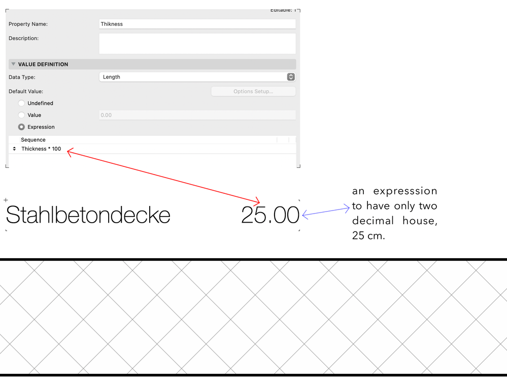

Hello everyone.
Can you help me to configure an expression to have the information as the attach picture. I guess is a simply one, is just to have meters in "cm" or "mm" and only with two decimal houses.
The solution using Calculation Units in the Options > Project Preferences > Calculation Units & Rules Dialog, doesn’t work for me because I do not want the schedules to use centimeter.
Thanks for your time to read my issue

Solution
Xandros
Hi
you could try the following. But need to change the datatype to text for this
STR ( Thickness / 1 m * 100; 2 )

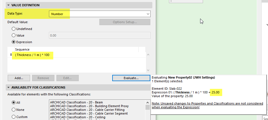

Solution
If you want your calculation to remain as a number, then you must set the data type as a number and convert the thickness in the expression to centimetres by dividing by 1m to remove the units.
Then multiply by the factor you want to increase / decrease by (100 in this case to get meters to centimetres).
You can then use this property in schedules and it will still add - but technically it has no units.

Xavi
Thank you  Xandros and Barry, for the quick reply.
Did work perfectly. I appreciate the help.
