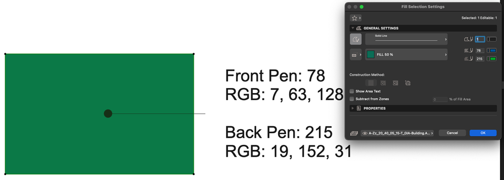

hi, its not possible to get the R, G, B values from cut fills pens overrides?
Jaime-airc_digital
I don't think is possible to list te RGB values of Graphical overrides directly, maybe exporting the rules to xml and extracting the values in a list outside Archicad.
What can be done with GDL is request the values of pens in your project, for example, I developed a label that displays the RGB values of any fill pens:
Maybe this would help in achieving what you are after?
