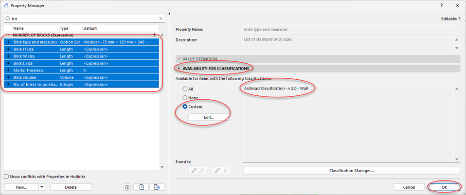

make sure the properties that you created has been assigned to the right classification of that element.

I agree with @Akpocky. All properties you want to use in Property Manager must be assigned to the right classification. If the brick wall is classified as v 2.0 Wall, you have to assign all properties to v 2.0 Wall. I had the same problem myself and solved it by doing this.
You also have to select the actual Wall to try the Evaluate function to see if it works.

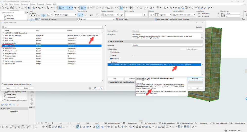

I have used the Add Button to add a new Option. Using both "x" and "*" as a Multiplication Sign. But only the first dimension of the Brick is calculated when I use the Evaluate function.
Above: The real width of the Brick is 120mm, but only the height (65mm) shows. All three dimensions are wrongly evaluated to 65mm: Height, Width and Length.

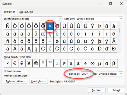

Finally I found out that Archicad here uses the Symbol 00D7 (Hotkey Alt+0215) as a Multiplication Sign. And that my "x" and "*" didn't work.
I used the same sign (00D7 - Hotkey Alt+0215) as a Multiplication Sign in the formula. Now it works 😊

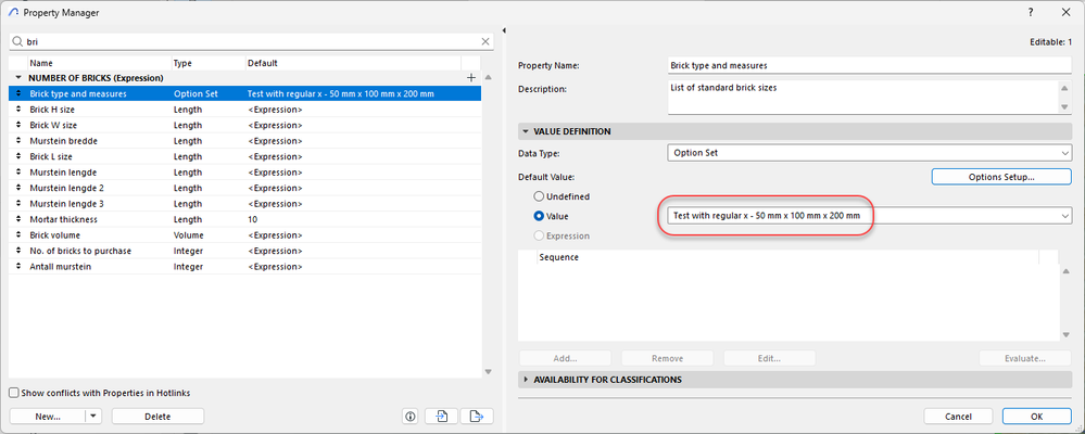

I have made a new Brick Type with the regular x between the dimensions:
Test with regular x - 50 mm x 100 mm x 200 mm
For Width the standard (wrong) formula is:
STRTONUM ( SPLIT ( SPLIT ( SPLITRIGHT ( SUBSTITUTE ( {Property:NUMBER OF BRICKS (Expression)/Brick type and measures}; " mm"; "" ); "-"; 2 ); " x"; 1 ); " × "; 2 ) ) * 1 mm
The regular x has number 1 besides, leading the result to the incorrect Height value of 50 mm. The Symbol × has number 2 besides, leading the correct result of the Width if you use the Symbol × in the formula.
For Length the code is similarly incorrect:
STRTONUM ( SPLIT ( SPLIT ( SPLITRIGHT ( SUBSTITUTE ( {Property:NUMBER OF BRICKS (Expression)/Brick type and measures}; " mm"; "" ); "-"; 2 ); " x"; 1 ); " × "; 3 ) ) * 1 mm
The regular x has number 1 besides, once more leading to the incorrect result of Height (50 mm). The Symbol × has number 3 besides, leading to the correct result of Length if you use the Symbol × in the formula.
As shown below:
For Width the correct formula will be:
STRTONUM ( SPLIT ( SPLIT ( SPLITRIGHT ( SUBSTITUTE ( {Property:NUMBER OF BRICKS (Expression)/Brick type and measures}; " mm"; "" ); "-"; 2 ); " x"; 2 ); " × "; 2 ) ) * 1 mm
For Length the correct code will be: STRTONUM ( SPLIT ( SPLIT ( SPLITRIGHT ( SUBSTITUTE ( {Property:NUMBER OF BRICKS (Expression)/Brick type and measures}; " mm"; "" ); "-"; 2 ); " x"; 3 ); " × "; 3 ) ) * 1 mm
This incorrect formula ought to be updated and corrected in v28 I think 😊
