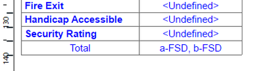

I want to make it a,b-FSD. Is it possible?
LeeJaeYoung

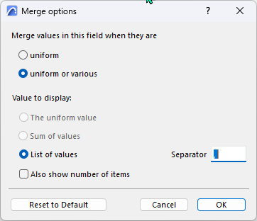

No, because you have 2 separate values that you are simply listing together.
One is 'a-FSD' and the other is 'b-FSD'.
The schedule can not merges similar bits of text in the values.
a,b are generation types.
FSD is the zone location.
Because the door installed on the balcony of household A is different from the door installed on the balcony of household B,
A, C, D - ROOM, B - ROOM This is a question I asked because there are many cases where it needs to be divided. I wish it could be resolved.
