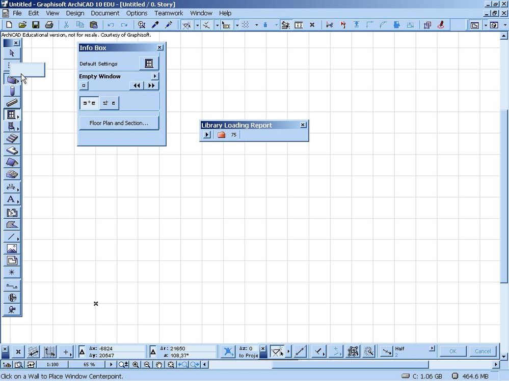

hello,
recently i switched to archicad 10 (edu international) from archicad 9.
and some elements of palettes like toolbox or coordinates are invisible,
i can click them, they work, but i can't see what icon i'm choosing.
Can anybody help me?
screenshots below
(i work on win xp pro, all open GL 3d elements in archicad work properly)

Try switching work environments. It might also be a video card/driver issue.

What are your video cards?
Jean Luc, you mentioned Intel. Is it integrated? That does not bode well ... and the memory is then deifnitely shared.
What are the computer specs? Memory, video memory? If the machines are branded, which exact models are they?

Hello,
Archicad 10 work out well on
Laptop:Inspiron 1100
Intel(R) Celeron(R) 2.20 Ghz
L2 128Kb
RAM:510Mb
Intel(R) 82845Gl/GE/PE/GV
driver 6.14.10.4342
1024x768 with 32 bit color depth
BUT NOT ON
Dell dimension 2400
Intel(R) Pentium (R) 4 CPU 2.80Ghz
L2 512Kb
RAM:1022Mb
driver 6.14.10.4342
Therefore I doudt that the problem is related to the video card
or the driver. Moreover so far Archicad 8 and 9 did work on both machines without problem.
regards
Jean-Luc

Both laptops that you have mentioned have the minimum configuration - even below minimum in the case of Inspiron that works (!)
I strongly suspect that the guys at local support are right - something in your Dell does not agree with 10. The lack of memory does not help ... whatever it is.
Can you try on another machine, maybe a desktop, or a Mac? Is it possible to expand RAM on any of the laptops?

Hello Djordje,
I already tried on another computer.
(ah ! the dell dimension is not a laptop but a desktop)
A Dell (again) Oplitex
Intel(R) Pentium(R) 4CPU 3.00 GHz
L2 cache: 1024
Memory: 1022Mb
Video card: Intel(R) 82865G Graphic controlled(still integrated)
It works !
I know how that will finish :new installation of windows xp !
I suspect a problem in the registry and a DLL problem.
