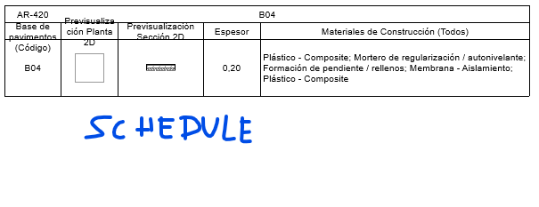

I can get that list and the thicknesses of each layer using the ā€œbill of materialsā€ tag.
But in the schedules, when I call up the material list parameter, neither thicknesses nor line breaks are included.

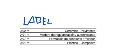

I need a column to appear in the table with the information formatted as follows:
B04
0,20
0.02 m - CerƔmico - Pavimento
0.01 m - Morte de regularización / autonivelante
0.07 m - Formación de pendiente/rellenos
0.01 - PlƔstico - Composite
I also can't find a way to call up that list of materials from the expressions in the properties editor. So I can't display that label information in the schedules.

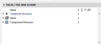

If I understood correctly, you want to display a composite name and each part of it plus the thickness in a different field.
To achieve that you can have something similar to this in the schedule fields, on the Components schedule:
Composite structure - you can tick the Show Headline so it groups them nicely, then the name of the building material (it will list each of them) and component thickness.
Further info here: https://community.graphisoft.com/t5/Project-data-BIM/Scheduling-Component-Data-of-Complex-Profile-St...

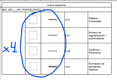

The problem remains that I need it to be a single field, as I want to use it for tables that serve as graphic legends for the plans.
We need something like this:
But in this case, we get something like this, with the plan and section views multiplied by the number of layers that make up the composite:
We understand that this may be a very specific use case for global use, but we don't see it as something very unusual in our environment either.
