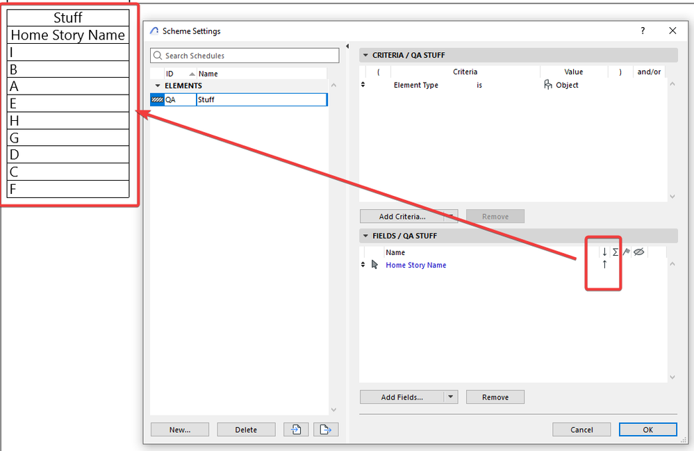

Can we please fix the scheduling of elements/ objects by "home storey name"?
Currently (since at least AC27) it sorts by "home storey number" regardless of how you set it.
If you want to sort "home storey name" alphabetically, you can't.
This is particularly helpful when scheduling HLMs created on negative storeys when they haven't been created 'logically' with the above in mind.

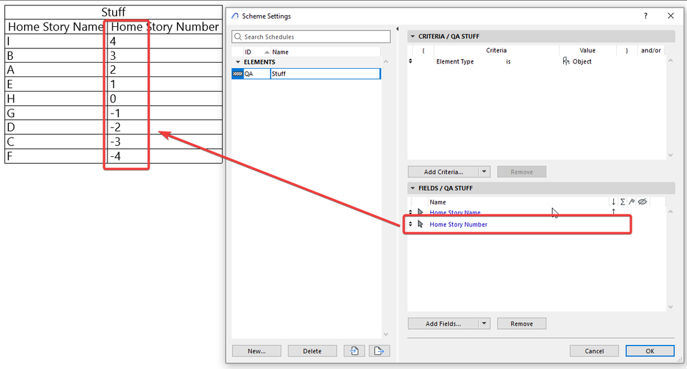

Yes, try naming them all randomly like this.
What it's doing is looking at the Home storey number and ignoring the name.

DamianW
Like this...

You are correct.
The name does not matter.
I guess the logic is that it makes sense for the storeys should be displayed in their physical order.

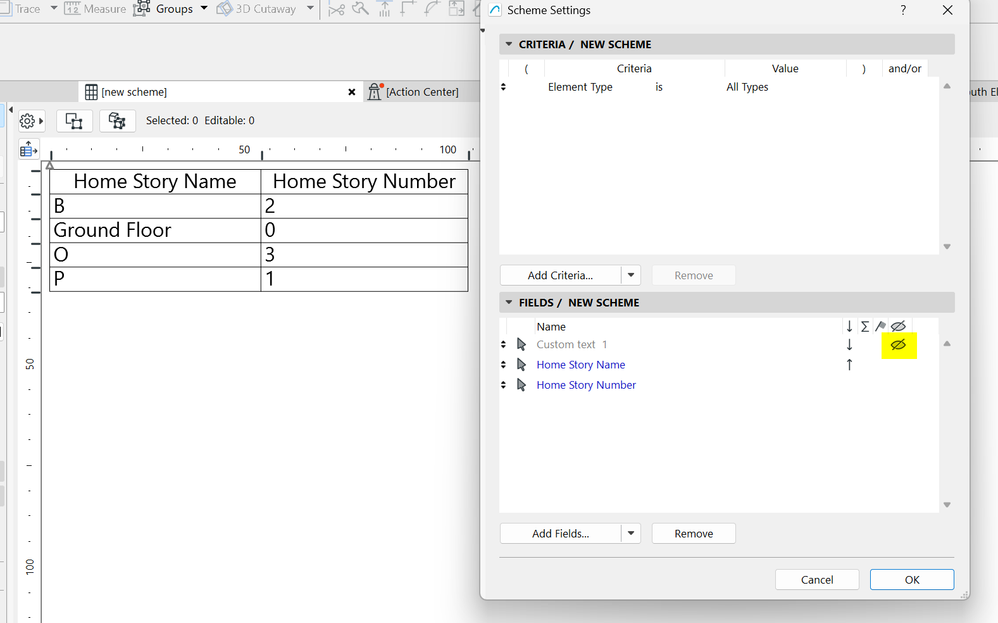

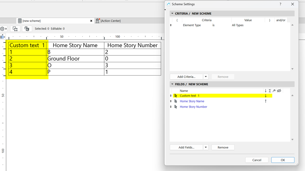

Another workaround would be to add custom text field and give sorting numbers and then
hide that field.
