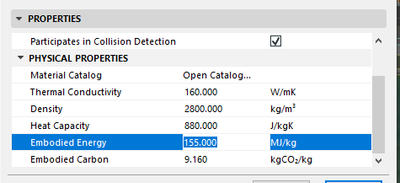

I  want to calculate the embodied carbon from my model, and I am trying to edit the building materials' physical properties.
As I know, the material catalog can load the physical properties, but the data is unsuitable for our country.
Can I edit the material catalog directly? or I can load it from my catalog.

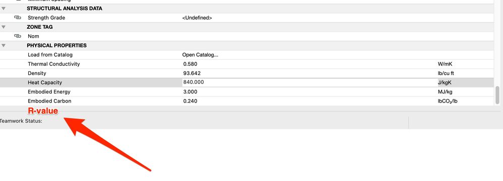

Thanks for the information but already know that we can modify from archicad the value . what we want to know is how to édit it we want to add a information like the R-value as a row. What softwares to use to édit .XML file on archicad

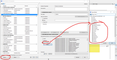

I don´t know if I understand you correctly, but you can create a new property and make it available to the materials:

Hello to everyone thanks for the answer but we already do that. What we want is to be able to modify the base of it and other .xml document. we need the software to edit those .xml so we put our need for the office.
Thanks for your suggestion, and yes, we modified the data in our template already. We keep trying to add more physical properties to building materials without creating a new tag in the property manager.
Yes, that was what we want. Is it possible to edit in XML editor?
