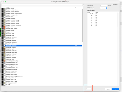

Unfortunately I'm having problems with getting the Building Materials LCA settings to be saved after I fill in the EPD-data and click OK. When I open the settings again, all the values are back to zero. Are there any specific classifications or other settings in the Building Material panel that has to be filled in for them to be mapped correct?
I'm testing in AC26 build 4022 SWE full.
I am also seeing a value input at the bottom, that moves around when I resize the panel window. Does that value do anything? see attached image.
