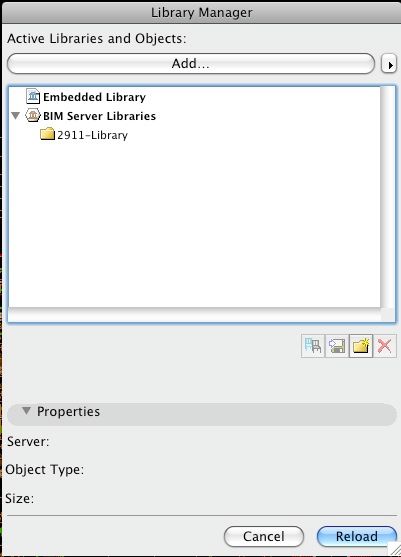

dearmariana
What if I've done all that and we still can't access our libraries?
We had a project that we were working on from two different computers, one AC13 one AC12... sharing the file over our network. We upgraded the AC12 to 13 and decided to give teamwork a try. Uploaded the server and all appropriate libraries. But we have missing objects everywhere, and no ability to add new objects. In the BIM library manager window, our libraries have been uploaded. In the Library Manager for the file, they are not listed under BIM Libraries, nor can we add them anymore. Whereas you used to be able to 'chose' a library, it now asks us to 'open' and 'open' and 'open' until we get all the way down to specific elements.

In the Library Manager Window, there is the Manage BIM Server Libraries button.
If you click it, you go to the Manage BIM Server Libraries Dialog, where you can login to the BIM Server and it will list the available libraries.
You need to select the Library in the list that you wish to add to your project and click the Add button. That will take you back to the Library manager Dialog and the library you just added will be listed under BIM Server Libraries. Then you need to Reload Libraries.
Is this what you are doing?

Hi laszlonagy, thanks for replying...
That is exactly what we did. Our libraries are listed correctly under the BIM Server Libraries in the Library Manager Dialog. We reloaded the libraries.
Then, when we want to create an object, in the Object Settings Dialog, where you should be able to search through the libraries - you cannot. They are not listed.
Any ideas?

Can you post a screenshot or two about this?
So you are saying that the library is loaded but the elements within the library are not listed in the Object Settings Dialog?
dearmariana
Sure - Our interface is in Italian, so sorry if I get the English names of things wrong...
here's the Library Manager Window
