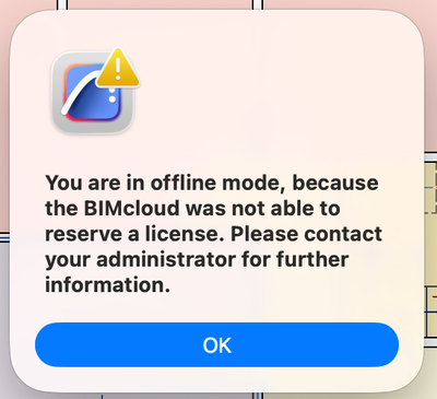

here is a small sampling of the t/w warnings I have been trouble shooting the past week. This feels like something is broken... or theres something else at play here (my tinfoil hat is on pretty tight right now). And these are about 1/4-1/2 of what I've been sent:

we just had half the office drop their connection - teams with deadlines are freaking out - what's going on with the BIMcloud today?
MarthaK
The current issue with the BIMcloud appears to be impacting multiple users. My entire office is unable to Send & Receive. We are a hybrid office, so this is not an issue with the WiFi.

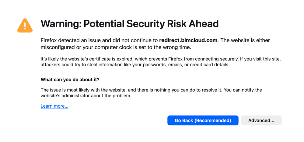

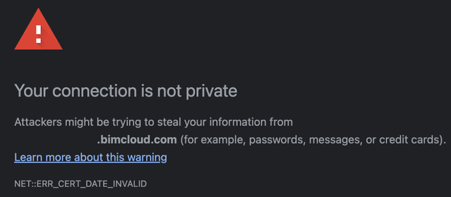

our whole office just lost connection to the BIMcloud - teams with deadlines are freaking out a little right now - I get a security warning when trying to direct access the server via a browser

TaniavH - this is the same thing happening in our office. I also get a security certificate warning when trying to open the BIMcloud SaaS web portal.

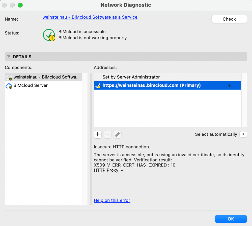

Here is some info about what happened:
https://community.graphisoft.com/t5/Graphisoft-Insights/BIMcloud-SaaS-Service-interruption-on-March-...
Should be back to normal by now. Or, you may need to
  • Restart your browser or Archicad
  • Clear cached data (this helps your system pick up the updated certificate)
