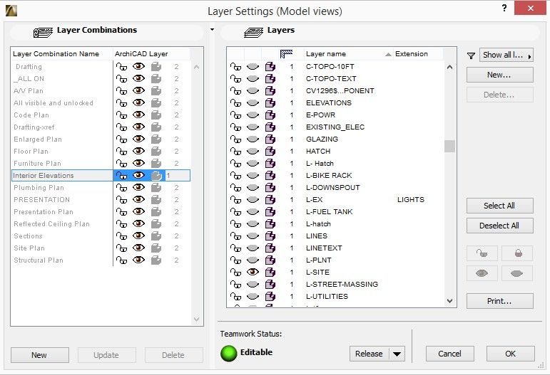

'Profile editor' not editable even though it says is should.
Profile editor not editable even though teamwork status say editable.
As you can see from the screencapture below, 'Teamwork Status' is 'Editable'.
Am i missing something?
I also 'released' the 'solid line' attribute as well.

In my experience when TW behaves like that it sometimes is because you need to do a send and receive. Also it might be that one of the items affected by editing the profile is not reserved.
As a test try creating a new profile and see if you can edit that.

Thanks Eduardo,
Yes i can create another profile, that's actually how i've been getting around this quirk.
Sending/Receiving doesn't free it up either.
I also 'reserved all' too, just to test that out.
Having similar issues with 'layer combination'--in that, it's 'editable', and i can change it, but when i send/recieve, if reverts back to previous value.

You could try to leave the project and rejoin it to see if that clears TW's "bowels".

found the answer...
was a combination of setting the proper permissions on users/roles...
http://www.archicadwiki.com/Teamwork/BimServerConfiguration
... and had to 'leave the project' for the permissions to take effect.
