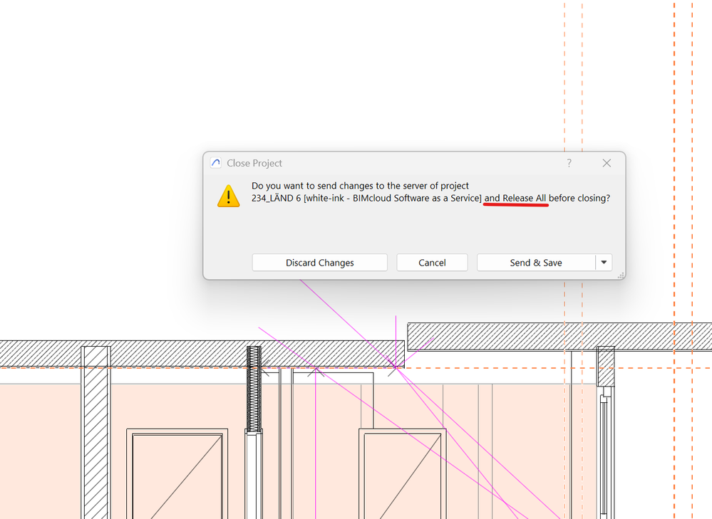

Release all when closing Teamwork File
Am I completely missing something, or is this a big nothing setting in the work environment? I have it checked, everyone I know has it checked. Everyone still deals with latent users (not in the file, but with inactive connections) retaining reservations after they have closed.
Is this a feature that only works for full BIMcloud, not BIMcloud basic? Or is it just a dummy box that was never fully developed?

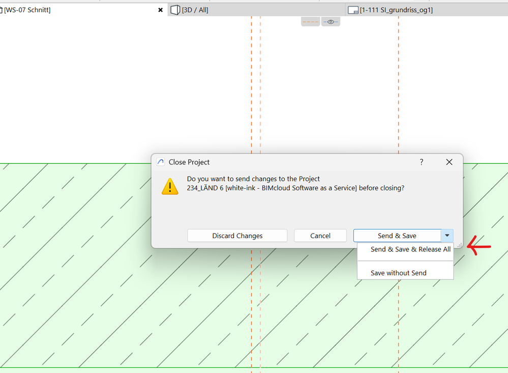

Yes, there in the Work Environment, but if you look at "All Commands in Alphabetical Order", you will see all available commands rather than just those already used in the menus.
But even then, I did not see a command for 'send & save and release all'.

I found it:
When you closed the project or program before sending changes if the option is not ticked on the Data and Safety menu this is the message, but when it´s active you get this
The problem that i still found is if you send changes just before, when you close this message that´s not appear.
Regards,
Hector

They should remove the "with Send Changes" bit, since as stated, if there are no changes to be sent, you do not get prompted to release...
