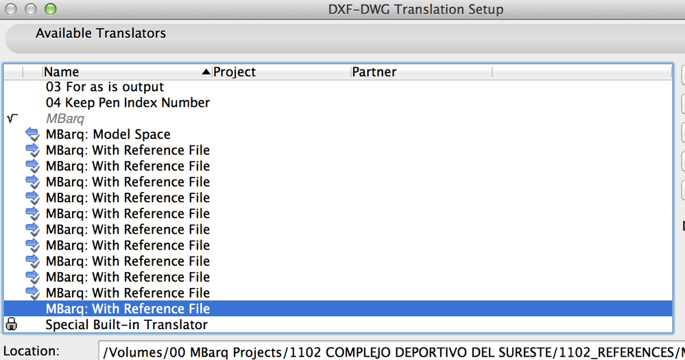

TW creating multiple DWG Translators when Publishing
Any idea?

Eduardo Rolon
Hotfix 02 didn't fix this.

schagemann
we just had this happen to us and we are now trying to find which directory has the wrong permissions - did you ever manage to find a fix for this… ?

Csaba Kezer
The translators getting duplicated is clearly the sign of ArchiCAD not having the permission to overwrite the original instance. You should check whether all folders in the path to the mounted volume allow full access for the clients:
- Right click on the Folder
- Get Info
- in Sharing & Permissions section change the permission to "Read & Write" for everyone.
Hope this helps,
Csaba
