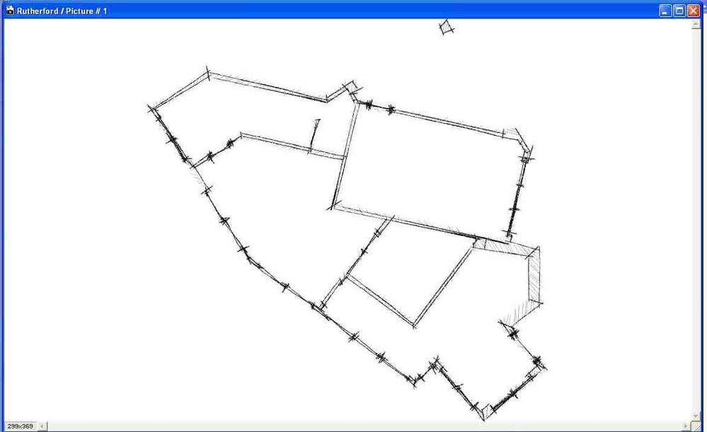

You could use 3d cutting planes, view in 3d, and use the sketch engine. As you will note you would have to have your doors open in 3d to have them read as doors. I use to use a program called powercad and I could copy everything from my plan window to the clipboard and paste straight into powercad. Here I had full control of all aspects of the squiggle effect and achieved very good results with minimal effort.

Nice idea. I suppose then notes, colours, etc could be added if required in Plotmaker to make a more sketchy sketch plan. I have found that since using AC clients sometimes miss the sketchy first stage of an architects service. However with this approach the drawing has a loose impression type feel.

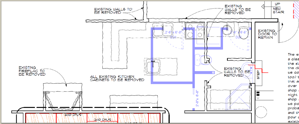

Steve Jepson
You can also create a wavy custom line type and select it as the line for your walls and other objects as well.
I use this to help show walls to be removed.
