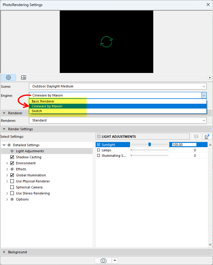

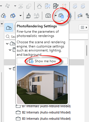

Yes Archicad has its own photo rendering  built in (search for 'photorendering' rather than renderingengine names).
I know you are not on 28, but that has learning content built in (see above).
I have a button for the photo rendering settings on my tool bar, but you will also find it in the WINDOWS > Palettes menu.
Once you have it open you will see the rendering engines you can use.

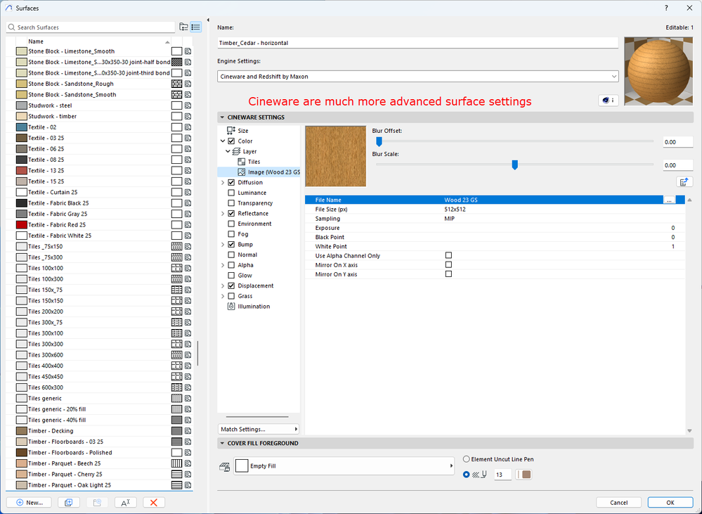

Basic renderer is just what you see in the 3D window and uses the basic (hardware) surfaces that you see on screen.
Cineware by Maxon uses the same 3D view but uses the alternate surface settings for Cineware (Cinerender) surfaces - you can't see these surfaces on screen until you do a render.
The sketch rendering engine uses the 3D view but produces sketchy line / painting style sketches.
If you have a high end graphics card, you may also get the option for a Redshift rendering engine (I do not have this).
Same surface settings as the Cineware surfaces.
Be warned there is much to set up with the surface settings and rendering settings.
And when using Cineware (Cinerender) there is no live view and you can not see the surfaces in the 3D window.
Also the Basic and Cinerender settings can be completely different.
You may see red bricks in the basic settings which is what you see in the 3D window, but in Cinerender it could be timber cladding and you won't know this until you use that surface in a render (that is an extreme example, but it can happen).
That is why some feel it is easier to use an external program such as Twinmotion, Enscape, Lumion, etc.
