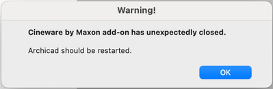

Arch Introini
I have Archicad 27 Build 5030 and when i render something sometimes i have this error: Cineware by maxon add-on has unexpectedly closed.
Even with Build 3001 i had the same problem.
It's very frustrating, could someone help me please?
Operating system used: Mac Apple Silicon Sonoma 14.5

I get the same error trying to run ArchiCAD 28 in Sonoma. See screenshot

This is happening because of faulty Cineware folder in installation folder of Archicad.
You can simply replace it with one copied from someone who does not have this problem.

That worked for me. Had the same problem in both AC27 and AC28
Thanks 😊

After replacing the Cineware folder with the one you suggested, I get this notice when I start ArchiCAD:
