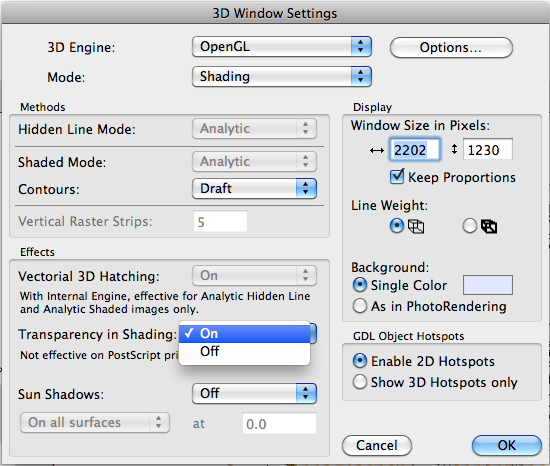

Have you checked in 3D Window Settings that Transparency is on?

And also make sure the transparency is set to over 70% in the material settings.
In my experience a Transmittance setting of 51 or more will make the material transparent in the 3D Window.

Hi David,
you're right.
Mind you, I didn't bother checking before posting, I was referring to previous behaviour in older versions 😉

The 51% threshold has been the rule for as long as I've been using ArchiCAD. Perhaps you mean before version 3? 😉
