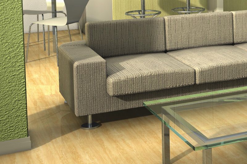

...because it cannot be posted full size here is a close-up. (now, I can see there is too much of bump
