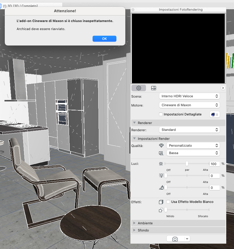

I'm having several problems with the Maxon render engine of archicad that closes every time I try to use it. I've already tried to restart archicad, I also reinstalled the add on and installed the latest update of archicad 28. How can I solve it?

If you have replaced the Cinerender folder with the working one also delete the Redshift folder within and it should then work. Make sure Archicad is closed or restart after you have e deleted the Redshift folder.

Follow the link in Laszlo's post.
Or to make it easy,,, https://graphisoft.sharefile.com/share/view/s0047a28b64a742b8930f768c6faf2a98

Are you on macOS 15 Sequoia?
There is a Cineware issue there. For details and the workaround, see this article:
https://community.graphisoft.com/t5/Installation-update/macOS-15-Sequoia/ta-p/616173
svpribyl
I have tried that workaround repeatedly, most recently yesterday, and it doesn't work for me.

I had not deleted the Redshift folder. It is working for me now!

Lee Hankins, could you please tell me where I can find the working one folder to replace (cinerender folder)?
charmingman12
Thank you Barry Kelly. I followed instructions and It works perfectly. Thank you very much

It’s because the updates reinstall the missing folder. Apparently it’s scheduled to be fixed in Archicad 30.
