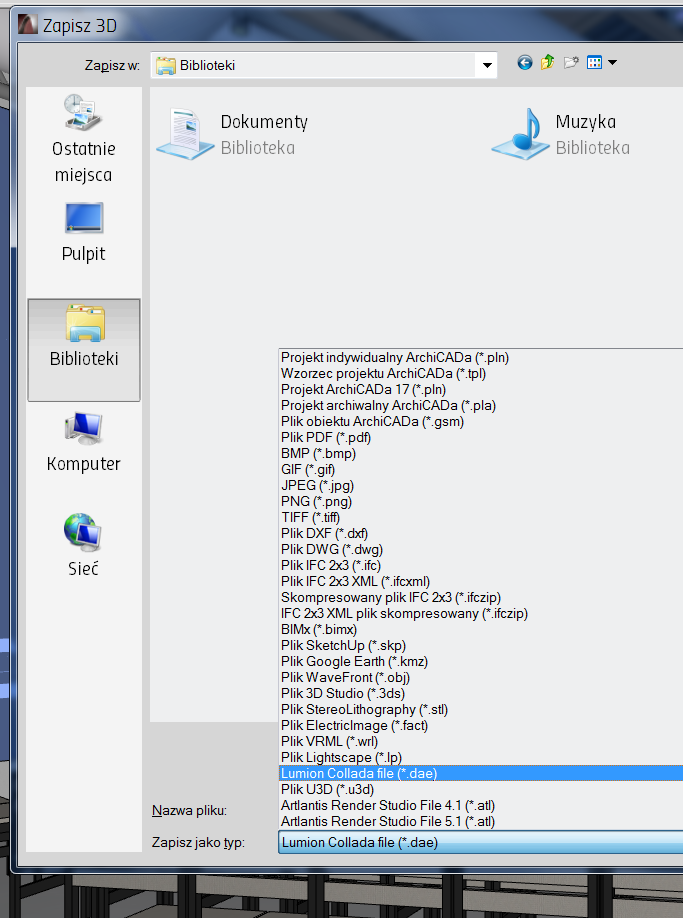

"How do you export to DAE directly from ArchiCAD?"
See attached picture.
"I don't think you can export to a realtime interactive environment, do you?"
No, you don't.

That seems an additional Collada Exporter, which is installed with Lumion. Would be nice to see if it provides a better model structure than the Google Earth exporter.
lumion3d.com/archicad-to-lumion-bridge/
Alas, this is Windows-only...
