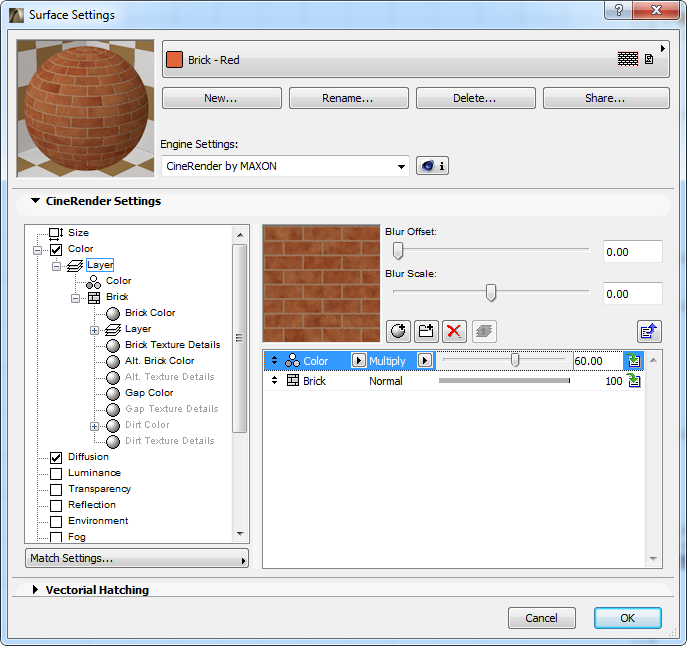

Here is the "Brick- Red" Surface. If I expand the Color channel, I can see that there is a Shader layer under it, which is the Brick shader.
To create the this effect we can add the Color shader layer to the Brick layer of the Color channel.
Select the Layer item in the left pane and in the list on the right you can see that in now consists of one layer: the Brick Shader.
Click the Add Shader button above the list of layers (the "sphere with a plus sign" icon) and a new shader layer is added to the list. By default it is a Color shader. Use the little drag handle before its name to drag up the list above the Brick shader layer.
This is important because layers are applied onto each other going from bottom to top. We want to apply an effect to the Brick shader layer in this case.

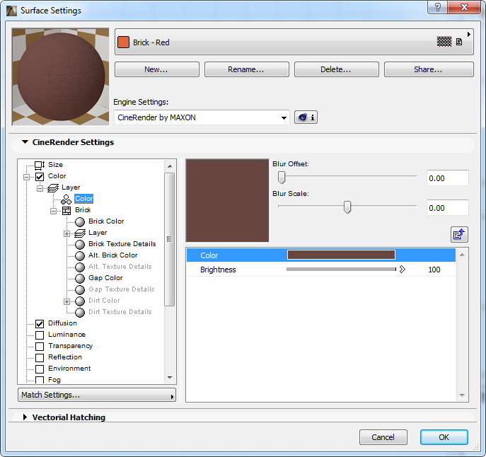

Now select the Color\Layer\Color item in the left pane and click the Color field in the list in the right pane to define the modifier color. In the attached image I set it to a dark, not too saturated brown color. In the upper left corner you can see that the whole surface became this dark brown color.
In the next step we can do something about that.
Again select the Color\Layer item in the left, and in the list on the right, adjust the Mixing Strength slider in the row of the Color shader layer. For example, if I adjust it to 60, the strength of this effect will be only 60%.
The second column in the list (where it says "Normal") is the Mix Mode column. That is where you can specify how the effect is applied to the shader below it, for example, does it taken into consideration the Color, the Hue, the Luminance of the input shader? You can experiment with those as well. For example, the Color or Multiply options may also give good results.
