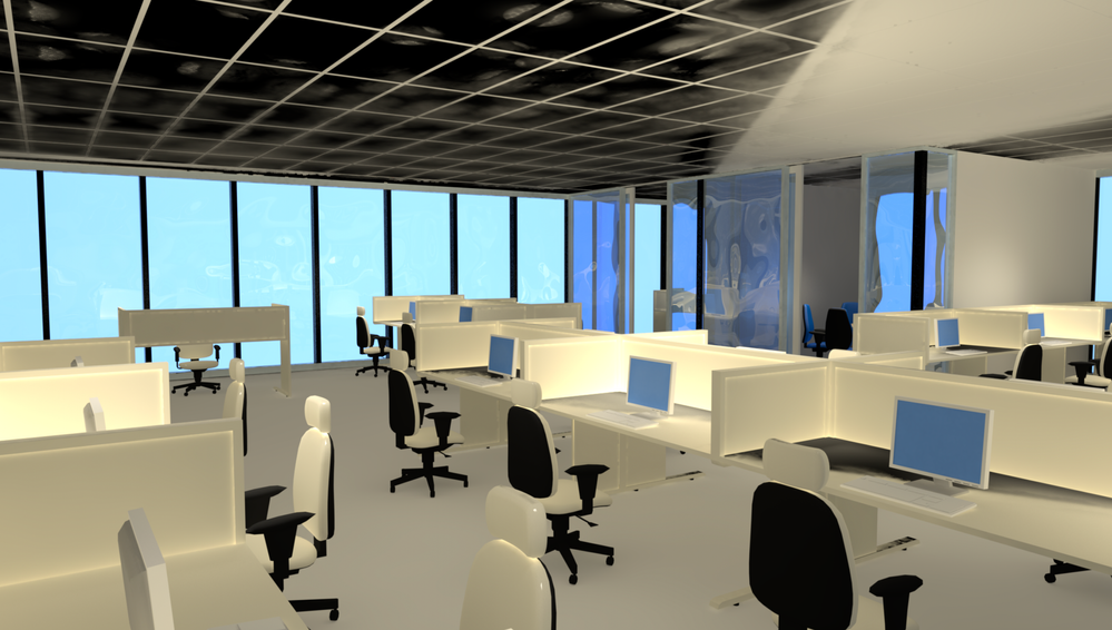

Hi everyone,
I'm trying to do a render of an office floor, and when I produce an image, so far I'm getting this obscure impact to the ceiling, and to a limited extent the floor (please see attached image). Can anyone explain how to stop this from happening, or will it resolve when I produce a higher quality render? I'm currently only working with medium quality renders as I will work to get all of the settings correct prior to taking the time to produce the high quality ones.
Thanks for your help in advance!
Henry.

@henrysaxby you seem to have forgotten to attach your image.
If you are talking about dark splotches it has got to do with the lighting. These will reduce / get smaller / disappear if your increase the number of light bounces / up your GI settings. You can always marquee a small area of your scene and render just that bit using a higher preset to see if it goes away.

The medium and high quality presets will lead to very long render times.
Try to set up some very basic source of lighting your interior, this doesn't have to be the actual fixtures, there are also generic light sources you can add (like a big invisible sphere that emits light).
If there is colour bleed on your ceiling, it means you have a highly reflective surface set up.
For dark splotches, it is as Ling pointed out above.
You can try importing the attached rendering scene, which are the settings we use for reasonably fast interior renderings.

Thanks for all of your advice, I'll definitely give this a go! @Lingwisyer, I didn't realise the picture didn't upload, I'll try to attach it again now. I'm very new to doing internal renders in such large spaces (office floors) so there is a lot of frustrating experimentation going on!
You can see the ceiling grid, but not the white 'panels' behind them, but only in certain places.

It looks like you have some sort of light source on the desk panels, like a LED strip. I wonder if they are causing issues with shadow casting and what not.
Try using the renderscene I included at something moderate like 195x135 mm at 300 dpi for a picture. It should render relatively fast and try with the light source on and off to see if the weird spots go away.

Might you happen to have a second intersecting entity with your ceiling grid such as your reference slab?
