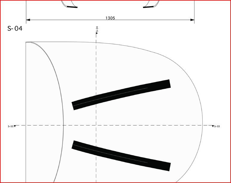

Here's a screen capture of the PDF file at default settings, directly from ArchiCAD.
If you have a PDF of your work, do your lines look similar to these or are they more crisp. ( I realise the upload may be lower quality )

It's too hard to tell from the attached image, primarily because it has been rendered at such a low resolution. Any chance you post an original PDF somewhere?
BTW - when you refer to the crispness of the lines, do you mean that lines look pixelated? Or does the antialiasing look a bit rough? Or are the lines too thick?

The lines look a bit rough. They look as if someone has taken sandpaper to the edges and removed the sharp, crisp line. I don't have my Mac with me but I will see if I can find the backup and possible upload a PDF to yousendit.com...
