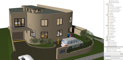

I have been trying to post a picture of the building in the 3D view however I keep getting this error.
Here is the building in the 3D view. A much better result than the 3D document.
