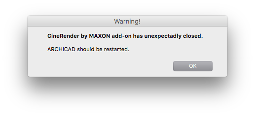

Everytime I Render a view it starts calculating the cgi and then it gets stuck at preparing 5.6%, eventually it says its finished but its not. When I open up render settings again I get the following error message
"Warning, cine render by maxon add on has unexpectedly close Archicad should be restarted. "

mi_jan
Error message window prompted when I click on the preview or on the render button in the render settings panel after the initial render try

i am having the same trouble in archicad 20 build 5011. when i choose to preview or render a scene that message pop up
i think everything happened after installing adobe premiere. have you found a solution so far ? . i found if set CineRender.exe to run as administrator (right click> compatibility>change setting for all users ) at least it stopped giving another error for maxon engine on startup
Eduardo Rolon
Jan's problem was fixed by unchecking the Grass Setting in C4D.

for that pc i have tried everything. uninstall, repair, copy cinerender folder from my working pc ,no grass enable dejrolon - thanks for trying to help- nothing . when trying to preview a render or choose to render the message " CineRender by MAXON add-on has unexpectedly closed." appears and suggests to restart archicad
p.s i also noticed that cinerender.exe doesnt run in taskmanager> processes even before i try to make a render, while on my restored working pc its there the moment i launch archicad 20.
help
update :
ok i think i found it after a long long struggle.
i think after reinstalling repairing Visual C++ Redistributable Packages for Visual Studio 2013
which i downloaded directly from microsoft the problem was solved. now cinerender loads in the background and preview and rendering with maxon engine work fine .

Hello Jver,
I think this problem should either come down to
- the RAM not being enough (the model is too detailed), so try to render a much smaller area first, and see if that helps.
- or a known issue with cinerender in general. You can read more about it here.
Let me know how it went.

Have you tried Daniel's suggestion: render a small area first (use marquee tool in 3D to mark out a small area) to rule out if it is caused by running out of memory due to too complex model.
The original poster problem was due to having the 'grass' effect on for a very large size terrain, for example, which will cause memory issues.
