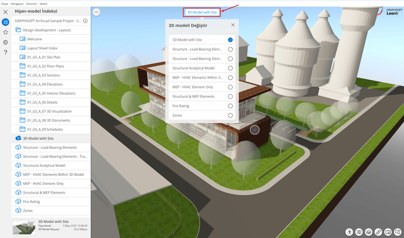

Hello,
You can save your design options as a view. If you publish these alternatives after that you can change them from BIMx.

Hello,
