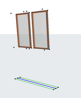

Would this work for you?
The wall is zero height and the material is air.

vistasp

ananas
Yes, i take that workaround 🙂
