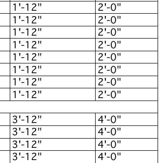

ok, folks, here's a new one for you:
In my window schedule, the dimensions are showing up as shown in the attached image. 1'-12"? 3'-12"? I've never seen ArchiCAD do that before.
The widths appear correctly in the window object. I've checked my dimension settings. The height displays correctly. I'm at a loss for how to correct this.
Any thoughts would be appreciated.

Your windows are probably not exactly 2-0 wide and are being rounded up, this is a known issue with rounding.
No problems here in the metric world as we do not round (typically)
Scott
jkershaw
Thanks for the reply. I've verified every which way that the windows are indeed 2'-0" wide.
Interestingly, the same window, when sized to other widths (e.g. 1'-0", 3'-0", 5'-0", 6'-0") will display that width correctly in the schedule.
Any other ideas?

jkershaw:
Try this: go to Working Units and change the Model Units to Feet & Decimal Inches, Decimals to 3 places. Select the troublesome window and see if it is a bit less than 2 feet, like 1'-11.990".

david -
thanks for the input. alas, the window still shows as being shop on. See attached image of the window tool dialog box.

jkershaw
also...
when I click on the window in the schedule itself, the dimensions show as being accurate. See attached.
Sadly, this sort of thing makes automatic scheduling useless for the time being.

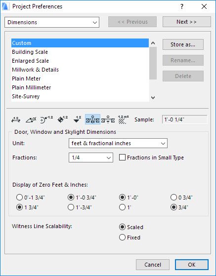

You might go here and try playing with the settings, especially the "fractions" setting. Note that this is specifically the dimension settings for doors/windows/skylights.

Daniel Kovacs
Graphisoft Alumni
Graphisoft Alumni
Hello!
This is actually a bug, that we know about.
All the background calculations in ARCHICAD are actually based on meters (whatever units you are using, the calculations are done in meters). The problem here, is that the algorithm we use to convert the results in the model and in the Interactive Schedule Add-on slightly differs, and the results after the conversion end up a fraction of a mm smaller in the Interactive Schedule, and since it seems smaller than 1', it will convert to 12" instead. The displayed value is actually correct, it is just in the wrong format.
This bug is on our to-do list, but it is deep in the code, so we are still working on a way to make it happen. I understand your frustration about this issue, sorry about the inconvenience!
