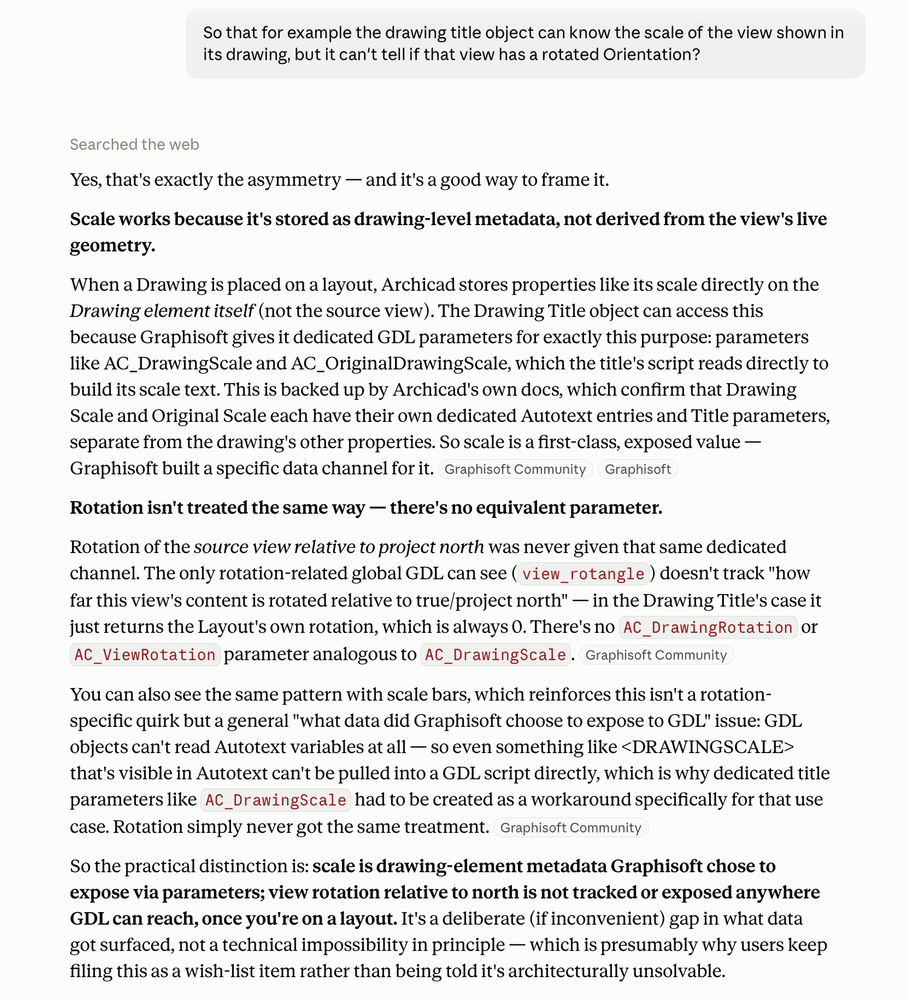

Is it somehow related to the view orientation (rotation, that is) data not being accesible to the drawing title object (not accessible as “drawing-level metadata”, says Claude)? In that case it would be two birds with one stone, given a stone.
