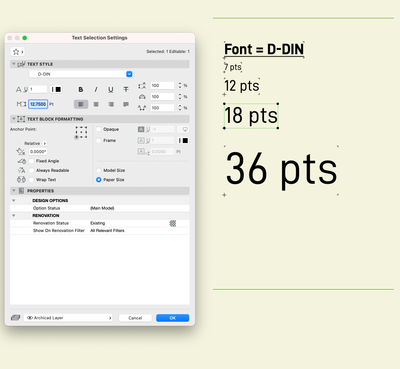

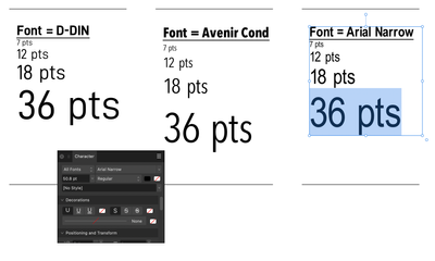

Fonts size set in AC:

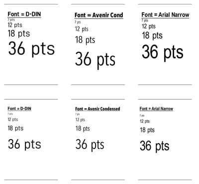

Exported as PDF and opened in Affinity Designer 36 pts is reported as 50.8 for all three font types:
In Affinity placed another set of fonts with the "correct" size:
Importing the PDF into AC and exploding. The correct font sizes are shown as:

Great detail, Eduardo. I have a dim memory (all memories are dim these days) that this was discussed at length in the past and that Graphisoft admitted to computing 'font metrics' incorrectly... including descenders and ascenders (including accent marks etc) improperly when computing the displayed point size... which is of course supposed to be exactly 72 points to the inch for the main character - NOT including descenders/ascenders/accents. E.g., an uppercase "A" at 72 points should measure one inch. If there is an accent mark on top, e.g., Á, Ä ... the "A" itself is still supposed to be 1" tall ... with the accent above that.

I remember that one which also included the lines spacing issue that can be seen in the screenshots. At least the fonts have the correct size, it is the displayed size in the Info Box which is incorrect.

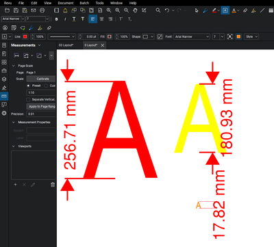

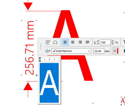

2024-02-26 03:28 AM - edited 2024-02-26 03:47 AM
Have you even wondered if everybody else is wrong and Archicad is correct?
Using Archicad 25 7000 AUS FULL
the red "A" is published from non-American Archicad,
Arial Narrow
set to 25.4mm
measured in bluebeam review, scale 1:10 = aprox 256mm
put in yellow "A" at 72 points
put in orange "A" at 7 points, its not 25mm, but 17.82mm at scale 1:10
I bring the PDF back into archicad,
The red A is still 25.4,
the 72point text from Bluebeam Revu = 17.99mm
and the 7point text is 1.75mm
have you checked what the output is, not what a program tells you?
that looks close to 1 inch to me...
don't confuse architectural text size with point size....
remember that point size is not the size of the "A" but the height of the character set, so 7point is not 2.5mm high text cap height, which is what Archicad measures...
Out of interest, can someone with AC USA edition post the physical measurement of a 72point Archicad text...Capital "A", Arial Narrow, so we all know the if its measurement 11, or measurement 13.

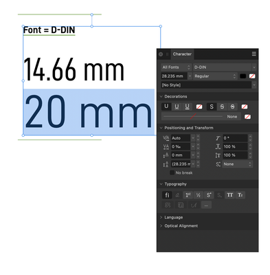

New test:
If I specify 20mm font size in Affinity and import to AC, size in AC should be 20*70.8 = ±14.16mm
And checking in AC:
Actual size is not changing. If text size in info box displays 20 everything is ok

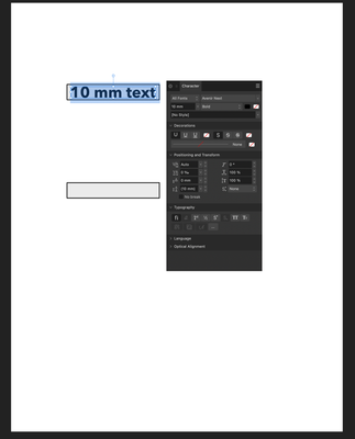

Another test to confirm that AC is wrong:
Affinity Designer:
AC:
And in Adobe Illustrator to rest my case:
