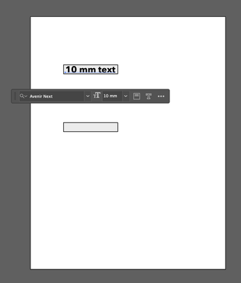

Another test to confirm that AC is wrong:
Affinity Designer:
AC:
And in Adobe Illustrator to rest my case:
Macbook Pro M1 Max 64GB ram, OS X 10.XX latest
