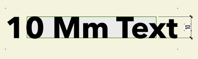

Don't think that working in mm helps, though OS might make a difference.
If you draw the 60x10 mm box in AC, the 10mm Text will not fit while it does on all of the other apps I have tried…

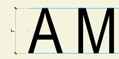

Everybody in this thread has missed the point.
"Why is this important?
Cad Standards minimum size for dimension text is 2.5mm which converts to 7.0xx points."
2.5mm text in architectural drawing is NOT a 7point font in other programs.
It IS text that touches 2 lines 2.5mm apart...
You can show me 1000 programs that say the same thing, but that is "WRONG" for architectural drawing standards, which measure the height of the character, not the height of the box that the characters all fit in.
The height is the capital "M" from the Top to the Bottom of the capital character, not the height of the font set.
Please show me a document for physical drafting where it says there is a significant gap between the guide lines for the letters and the text being drawn.
It is a shame that for the American version of Archicad they use a term for the capital character text height which doesn't match the standards for other programs that describe it in font set heights, and has led to confusion, but it is correct in the rest of the Archicad versions that use millimeters to measure the text height.
even the example shows the text being 10mm in the previous example, look the "1" and the "t" are 10mm high  🙂
I think that everybody here who has commented about things fitting in boxes are too young to have drawn by hand and do not know what text height is on a piece of paper.
The Architectural University I went to was a psychometric one that looked at how people experience the environment, so we learnt about how aging people need text to be larger, hence a minimum of 2.5mm (character height and in capitals) to be readable by supervisors/experienced (older) people on site.

OK, think I have it now.
AC measures "Font Height" which is different from "Font Size" so the rule is "minimum text HEIGHT has to be 2.5mm" not 25mm font Size.
So for my projects that specified 18 pts size if I want to use AC then I need to use the ±70% scale.
This shouldn't say Size it should say Font Height.
and the wish could be to have both measurements so that I can avoid this brain fart in the future…
As you wrote in your first post "AC is right and everybody else in the world is wrong…" but in truth everybody is right…

Archicad its value 11 for text height, design programs its value 13 for font size...completely different measurements.
the difference in your example is a factor of 51/72 = 0.70833333333333333333

Cap Height, better than Font Height, and not Font Size?

Eduardo, make a wish/request to Graphisoft to change/fix the name...it should say "Capital Height and Rotation" or "Text Height and Rotation", as it refers to text size not font size.
