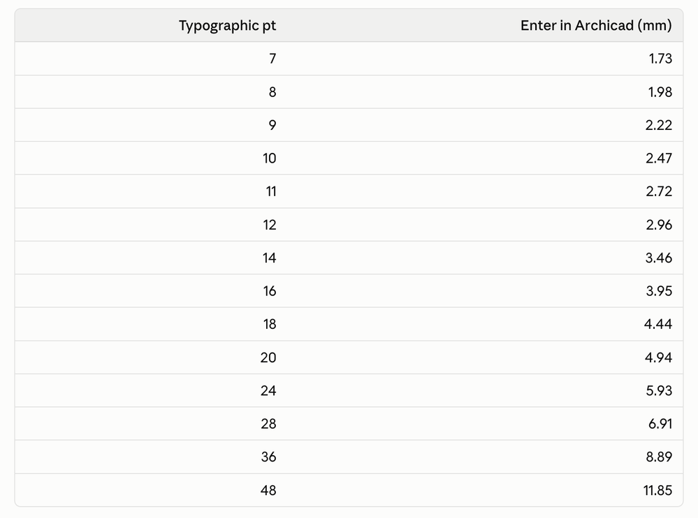

Giving this a bump because regardless of whomever is correct there is a (big) disconnect between Typographic Point Size in every other app and Archicad. I have just been caught out.
Firstly though, 'Pt' size for text is not available when Working Units use a metric system. This is the first thing that needs correcting: Pts should be available regardless - all other word processing, desktop publishing, and page layout applications use Pts regardless of any other system of measurement in place.
And Archicad 'Pt's need to be aligned with true Typographic Point sizing so that we can rely on a Xpt font being printed at the same size from all places. This is quite important for any company's output consistency. For reference, my 10pt 'M' letter height in Archicad measures as a full 1mm bigger (3.5mm) than in other applications (2.5mm).
The more I drill in to this, the more I am convinced that Graphisoft have got their Em Square height mixed up with their capital letter height. The 'Em Square' height being the bounding box of the whole font glyph set (including all the risers, tails, curly bits and inflections - or whatever they're called). Every other application under the sun seems to set the font height by the Em Square height - which is bigger. GS's own GUI shows the dimensions for the Text tool settings referring to the capital letter height.
I found this formula which should clear it all up:
cap height (mm) = (capHeight / unitsPerEm) × pointSize × (25.4 / 72)
Where 'capHeight' (or 'sCapHeight') and 'unitsPerEm' are defined in the font file itself, and 25.4/72 converts points to mm. GS just need to put two interlinked parameters in the Text tool settings: Text Size (Em Height) and Text Size (Capitals). Or even just 'Text (Pts)' and 'Text (mm)'. Both visible at the same time and one naturally alters the other - Pts referring to the Em Height and proper typographic measurement, and mm referring to the caps height. 'Text (mm)' would need to become 'Text (in)' for imperial systems is all, but both get Pts and both can clearly see what they're getting!
(And for what it's worth - for any font nerd out there like me - in doing this research I came across the website 'FontDrop': https://fontdrop.info/ You simply drop your font file on the webpage and you get to see how all of the magic happens. 🙂 )
~/b
b e n _ f r o s t
__archiben
I got Claude to give me a cheat sheet for the font I'm using. But in case anyone else needs one:
Archicad mm = point size × 25.4/72 × capHeight/UPM
Just make sure you substitute the sCapHeight and unitsPerEm for your own particular font using the fontdrop website above.
