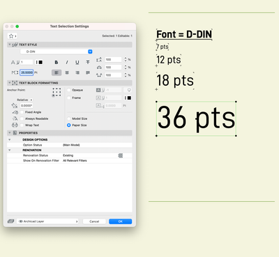

Recently I had to import a specific PDF which had specific font sizes that I had to keep.
After import and exploding the PDF the point size in AC was wrong.
It had not changed size since the drawing was at 1:1 scale but what was 18pts in Pages, Illustrator, Affinity Designer, was "reported" as 12.5 pts in AC.
If I set the font size in AC and then exported the PDF what in AC was 18 pts became 25.4 pts in every other graphics program. Size didn't change.

Fonts size set in AC:
Exported as PDF and opened in Affinity Designer 36 pts is reported as 50.8 for all three font types:
In Affinity placed another set of fonts with the "correct" size:
Importing the PDF into AC and exploding. The correct font sizes are shown as:

OK, think I have it now.
AC measures "Font Height" which is different from "Font Size" so the rule is "minimum text HEIGHT has to be 2.5mm" not 25mm font Size.
So for my projects that specified 18 pts size if I want to use AC then I need to use the ±70% scale.
This shouldn't say Size it should say Font Height.
and the wish could be to have both measurements so that I can avoid this brain fart in the future…

Archicad its value 11 for text height, design programs its value 13 for font size...completely different measurements.
the difference in your example is a factor of 51/72 = 0.70833333333333333333

Giving this a bump because regardless of whomever is correct there is a (big) disconnect between Typographic Point Size in every other app and Archicad. I have just been caught out.
Firstly though, 'Pt' size for text is not available when Working Units use a metric system. This is the first thing that needs correcting: Pts should be available regardless - all other word processing, desktop publishing, and page layout applications use Pts regardless of any other system of measurement in place.
And Archicad 'Pt's need to be aligned with true Typographic Point sizing so that we can rely on a Xpt font being printed at the same size from all places. This is quite important for any company's output consistency. For reference, my 10pt 'M' letter height in Archicad measures as a full 1mm bigger (3.5mm) than in other applications (2.5mm).
The more I drill in to this, the more I am convinced that Graphisoft have got their Em Square height mixed up with their capital letter height. The 'Em Square' height being the bounding box of the whole font glyph set (including all the risers, tails, curly bits and inflections - or whatever they're called). Every other application under the sun seems to set the font height by the Em Square height - which is bigger. GS's own GUI shows the dimensions for the Text tool settings referring to the capital letter height.
I found this formula which should clear it all up:
cap height (mm) = (sCapHeight / unitsPerEm) × pointSize × (25.4 / 72)
Where 'sCapHeight' and 'unitsPerEm' are defined in the font file itself, and 25.4/72 converts points to mm. GS just need to put two interlinked parameters in the Text tool settings: Text Size (Em Height) and Text Size (Capitals). Or even just 'Text (Pts)' and 'Text (mm)'. Both visible at the same time and one naturally alters the other - Pts referring to the Em Height and proper typographic measurement, and mm referring to the caps height. 'Text (mm)' would need to become 'Text (in)' for imperial systems is all, but both get Pts and both can clearly see what they're getting!
