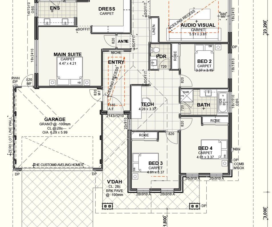

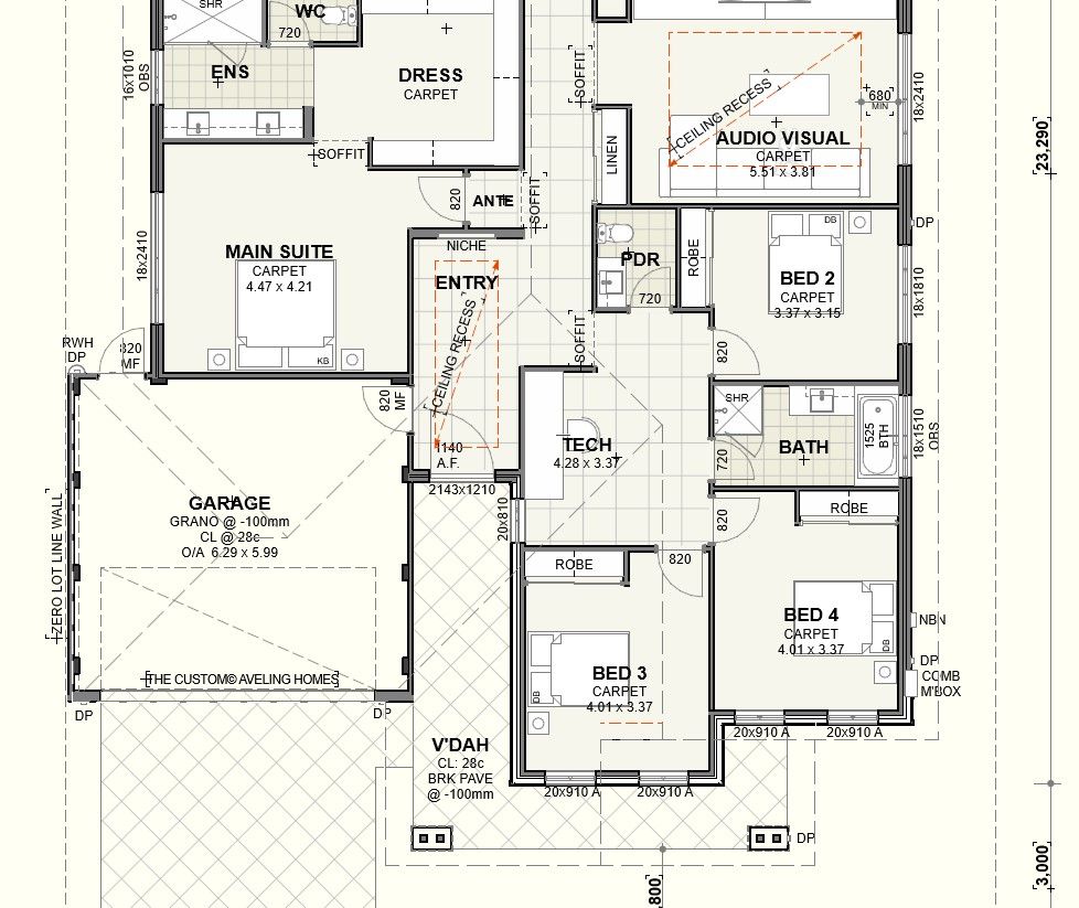

MarkT
What's the trade off one should ask. I did the registry hack and while some may have found 2D navigation an improvement, I'm not seeing it in the on-screen 2D quality. Maybe it's these older PC's & GPU but everything gets real fuzzy with the registry hack.
AC3.14 (1990) to AC29 (2026)
PC : i9 14900k @ 3.2GHz - RAM 96GB - W11
Karl Wir_n
Mark, I haven't noticed any fuzzy graphics after changing the rendering API.  If you haven't already, try switching off the 2d drawing antialiasing. This will make your graphics sharper, especially when zoomed out.
Go to Options -> Work Environment -> Advanced Redraw Options and uncheck 2D Drawing Antialiasing.
