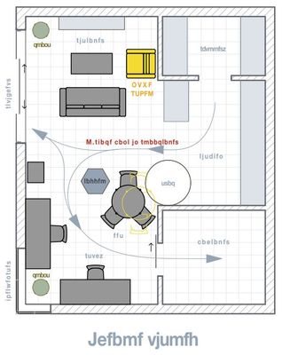

I recently upgraded my student package to ArchiCAD 26. When I add text to my project everything is fine in the drawing and in the layout book, but once I export to pdf all the letters are jumbled. It seems each letter gets shifted up by one in alphabetical order ("A" becomes "B", "B" becomes "C", etc.)

2023-10-11 03:10 PM
Oh what a simple solution. Changing the font worked.
I am assuming a glitch occurred when the project was converted from version 25 to 26.
Problem solved when I changed the font to Ariel. But for reference:
- I used Helvetica Neue initially
- I printed via the pdf-printer
Thanks for the simple, yet life-saving suggestions!

Just curious, if you change the font back to Helvetica Neue and try to print, does the character offset happen again?
| AC22-28 AUS 3110 | Help Those Help You - Add a Signature |
| Win11 | i9 10850K | 64GB | RX6600 | Win11 | R5 2600 | 16GB | GTX1660 |
2023-10-13 08:02 AM
Indeed, Helvetica Neue doesn't seem to print properly at all.
