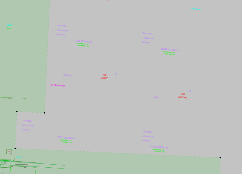

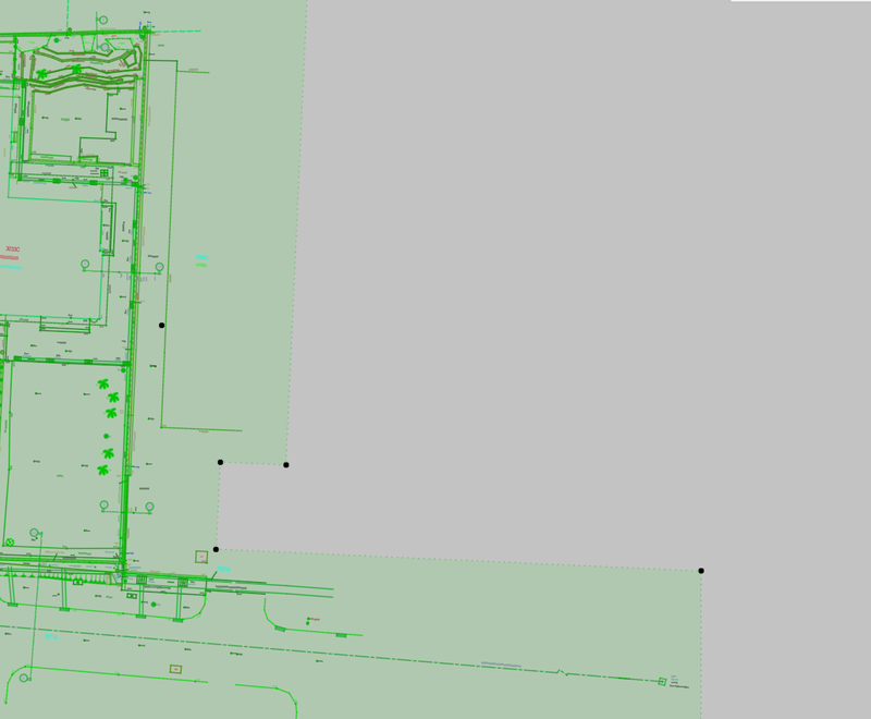

Hi to all,
Has anyone encounter this issue within the layout of Archicad 27 (build 4060) Teamwork?
It seems even if I cropped the drawing view it still shows those text that I want to hide, am I missing anything here?
See image below.
Zoomed out
Zoomed in
Any help would be greatly appreciated.
Thanks!

Yes, that's an actual issue, but if it helps, I can tell you that when publishing it to PDF those hidden figures are not visible. I mean the issue appears only in the workspace but not in the published product.

Seems to be an issue.
https://community.graphisoft.com/t5/Documentation/AC27-Text-NOT-Cropping-in-Layout/m-p/572565
Be sure to report it to your local support.

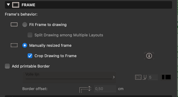

I had the same problem. By setting fit frame to drawing to manually resized frame and then switching back to fit frame to drawing, everything was ok again. Not the most durable solution.... But it worked
Apple M1 Max 32 GB Ventura
AC27

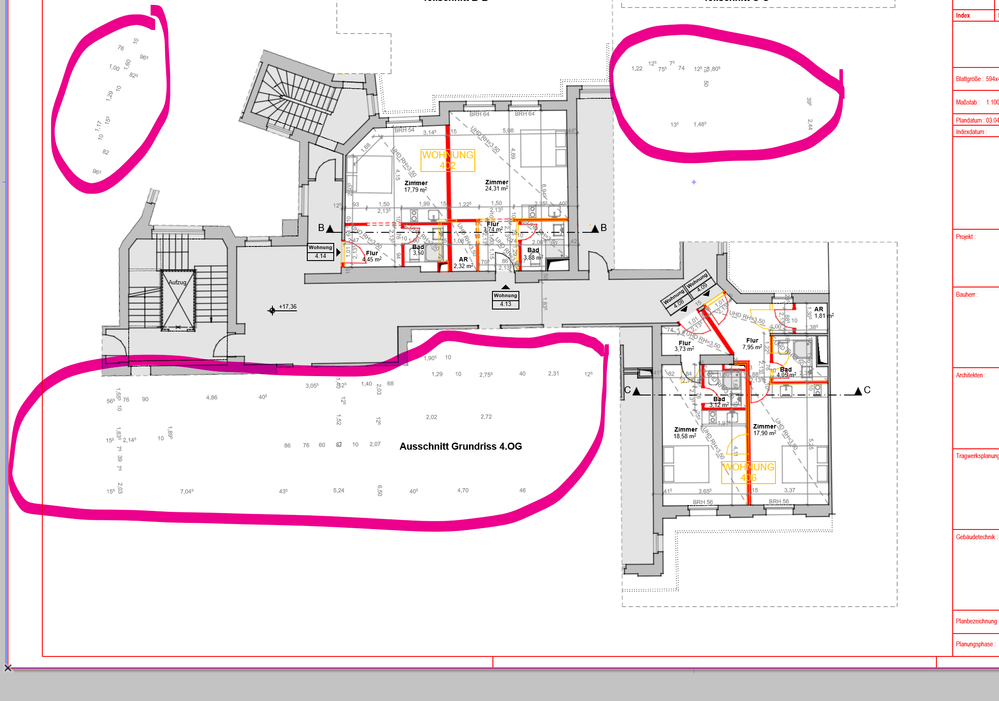

I guess this problem could be solved somewhere through editing the settings of the work enviroment but can´t find the way to do it. I croped a drawing and it still display the numbers of the measuring outside the croped area. How do I do so they don´t appear?
