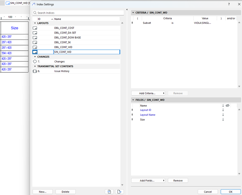

Do you know of a way to create:
Auto-text that reads the sheet size in layout space, eg. A1,
I know it can be done through index setting, however I want to see this displayed as A1 etc not the actual size.
See example below..

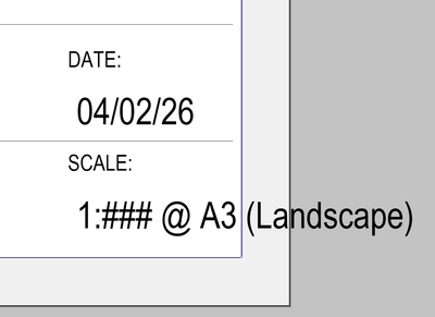

You can use autotext to read the master layout name. i've started to use this and (very crudely) hang the label off the drawing's edge...
obviously the naming convention would need to suit
