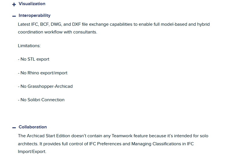

Are you sure you can not publish as PDF?
I would be very surprised if you can't.
I don't have Start edition to verify, but in the comparison with 26, it does not mention there is no PDF.
Mind you it also does not mention exactly what formats you can publish to.

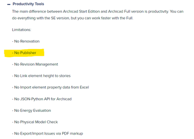

It seems that the SE version doesn't have the Publisher tool (which is a serious deficit). But saving to pdf is most likely possible.
| Archicad 4.5 - 29
| HP Z840 | 2× E5-2643 v4 | 64 GB RAM | Quadro M5000 | Windows 10 Pro x64
| HP Z4 G4 | W-2245 | 64 GB RAM | RTX A4000 | Windows 11
Really, no publisher.
That is just stupid in my opinion.
So in SE you have to 'save' every single layout page?
I am sure you can 'save as' a PDF file as someone else mentioned, but to have to do that for every layout page - my mind boggles.
I am downloading the Start Edition to see for myself.
I just installed SE22 (AUS) and nope, there is no Publisher.
I know it is a cut down version, but publishing is pretty important.
But yes, you can 'save as' or 'print' each layout as a PDF.
Painful, but possible.

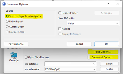

Barry, I tried to "save as PDF" the project and it saved 90 pages of PDF. 😳
I'll try to take a closer look, thanks for the tip.
Miha_M
Before saving your layouts to pdf you'll need to define the paper size through Page Options and set the Document Options, as you'll probably want to save multiple Layouts at once:
