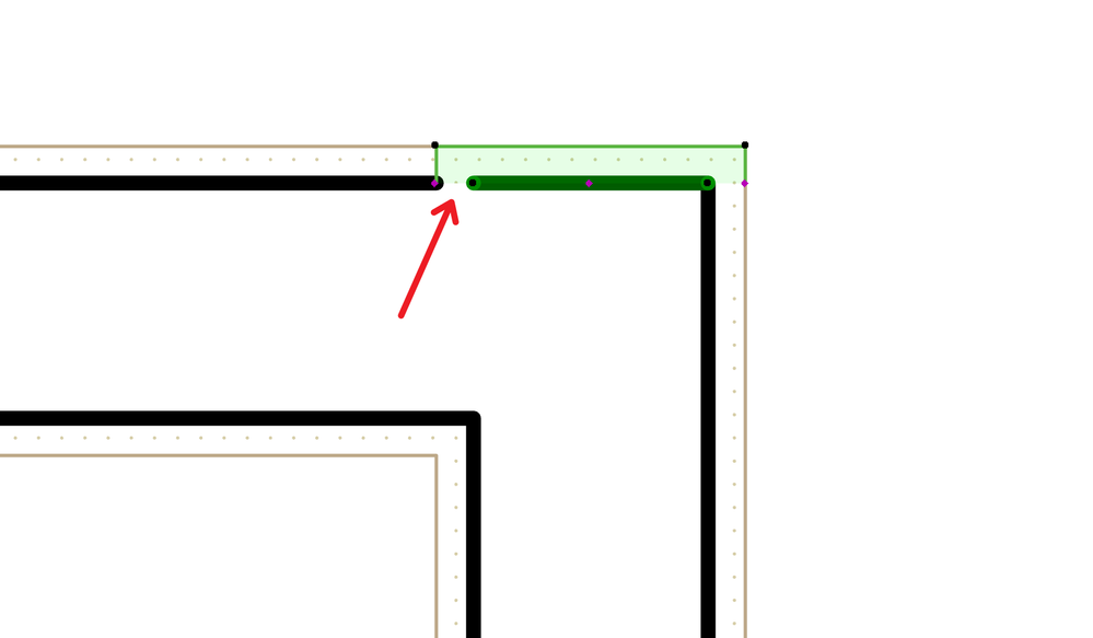

Hi guys, I have a problem. When the composite walls intersect, the mortar layer is not closed. I think I set the material right. but why the mortar is not cover the concrete wall end.

If it's a single problem you can use this method. But if you have many corners with similar problems I think you're better off with barry's solution.
2022-09-02 10:34 AM - edited 2022-09-02 10:58 AM
@Barry Kelly Yes, there is a need to break the corner connection. It is possible to insert the Wall End tool as you wrote.
There is another way, I extend the wall beyond the plaster to the outer edge of the wall and then just click on the end of the wall and Wall End is placed correct.
Of course, your way has advantages because it only has walls.
But if we are talking about template, I cannot adjust the template to a specific case like this and give the same strength for brick and concrete for single problem, because for another user of the template it will be incomprehensible and not needed, in our projects concrete usually has a stronger priority.
2022-09-02 10:35 AM - edited 2022-09-02 10:37 AM
Wall end (I used Wall End 1) does work but there are a few steps to follow.
Actually it is easier to place the wall end, stretch the wall back and then adjust the wall end sizes as you will have the other wall to snap to.

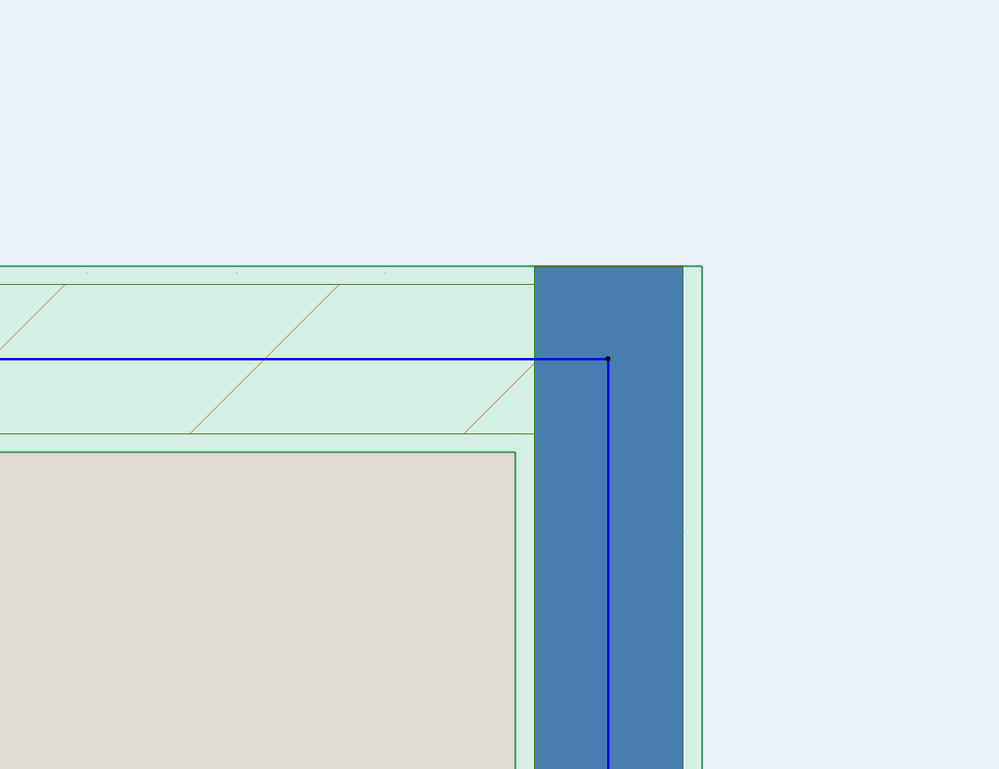

2022-09-02 02:12 PM
I tried the wall end method, and not 100% perfect.
2022-09-02 02:28 PM - edited 2022-09-02 02:40 PM
Hi William
You should select/unselect "Flip Turn Direction" in Setting Dialog.
As long as you have "Returned End" element used.
2022-09-02 02:37 PM
And I have spotted you have a line on plaster, you should unselect "Line between identical fills"
2022-09-02 02:50 PM
2022-09-02 03:24 PM
Thank you very much!
