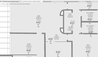

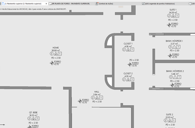

I created a custom label to get the base level of the slab. And it works fine.
But not on the sheets:
11 Replies 11

Note whether you have plans automatically updated with subsequent edits, if not, try manually.
Alternatively, save the current plan view and place it on the sheet this way.
Proud member of UNION.ARCHI Network
Henrique
Thanks for the answer, Qualifa.
The drawing is updated and saved as a view.
But to left no doubts, i updated it again and recreated another one..
I also updated the software.
The issue remains... and i think it's a bug. But i can't find where to report the bug..

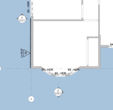

I have the same problem. I have a custom label that displays correctly in view map but loses its values in Layout. See screen shots:

@Henrique @Robby This is a known bug in AC 25 that reportedly will not be fixed until Update 2, coming later this fall.  See this thread:
https://community.graphisoft.com/t5/Document-Visualize-forum/Autotext-problem-between-view-amp-Layou...
