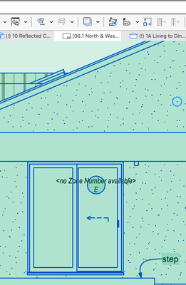

Door window table shows zone number in the elevation:
But not when placed on a layout:
Why not? Doesn't Layout display the view?

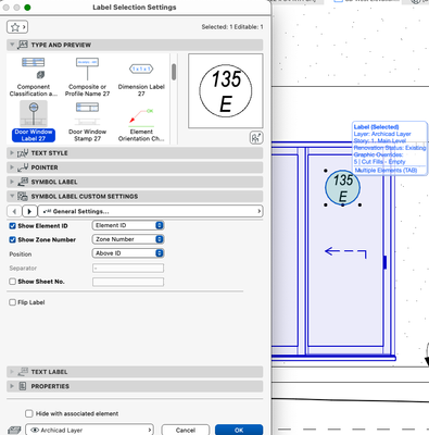

Here's the Label's relevant settings.

Select the drawing on the layout and choose "Open Source View".
Does it show the zone name now?
If not then the view settings are incorrect (zone layer turned off maybe?).
If it does show correctly, I am not sure of the problem without trying this myself, which I can't do just at the moment.
Exactly the problem!  Zone number displays properly in source view, but not when source view is placed on layout.
