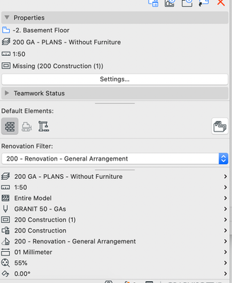

It's definitely to do with a MISSING MVO. 
I hadn't spotted it was missing at first.
It doesn't say its missing in the Quick Options palette but it does say it's missing in the Saved View Options.
Screen shot attached.
Refining the Saved View seems to have fixed it.

Tom,
Are you saying that the Quick Options Palette (you do mean the Quick Options Palette, not the Quick Options bar at the bottom of the Archicad Window, right?) and the View Settings Dialog display different values for the "Model View Options" field? That sounds like a bug too me. Could you also tell me your Archicad version and build number?
tom vincent
Hi Laszlo.
That's correct.
In the Quick Options palette it says the MVO is 200 Construction (1).
In the view settings dialogue it says the MVO is Missing (200 Construction (1)).
It's referring to the same MVO but it says that it's missing in one place but not the other.
Archicad 24 6004 UKI FULL
Tom
Sounds like a bug to me, I will report it to GS HQ.

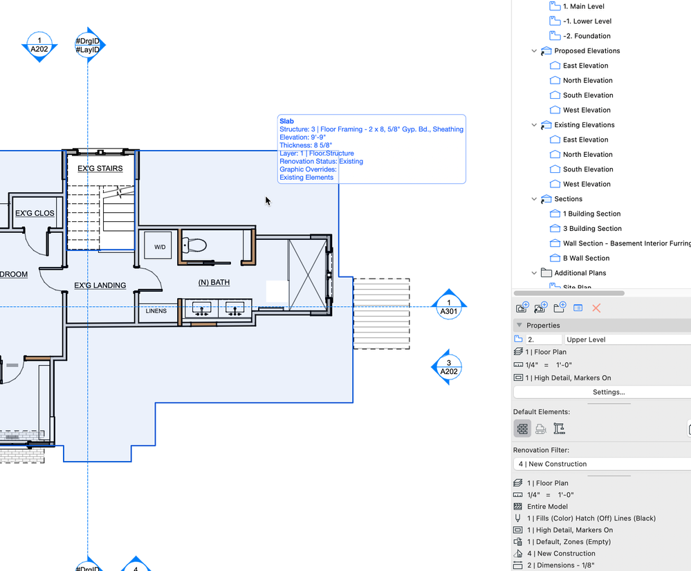

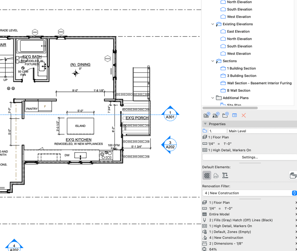

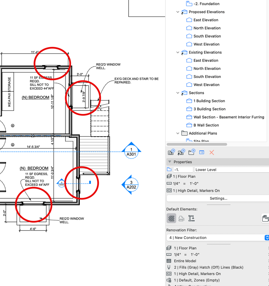

I am having a similar issue but with somewhat different details: I have three floor plans, with all levels set with MVO set to "high detail, markers on" but the window tags show in the main level and upper level, but not the lower. no issue with door tags, just the windows.
