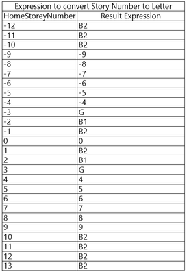

Hi
you could try the following addition to your expression to achieve a result.
But have a look at the screenshot below for the outcome and change your expression accordingly:
IFS (
CONTAINS ( "1", STR ( {Property:General Parameters/Home Story Number} ) ), "B2",
CONTAINS ( "2", STR ( {Property:General Parameters/Home Story Number} ) ), "B1",
CONTAINS ( "3", STR ( {Property:General Parameters/Home Story Number} ) ), "G",
TRUE, STR ( {Property:General Parameters/Home Story Number}, 0 ) )

@Xandros How did you create that table?
  1. I created an empty file with a few storeys (-12 to 13)
  2. added the expression as a property available to every classification
  3. placed an element (wall for example) on each storey
  4. created an interactive schedule
    • criteria set to fit those placed elements
    • fields are HomeStoreyNumber and the property containing the expression
  5. if number of elements per storey is bigger than 1 (for example if this schedule is created in an already existing project), use the option to merge the scheduled items
