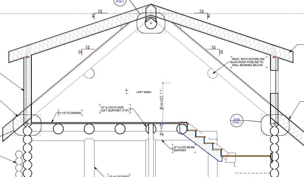

how do i show hidden elements in section view? in this case i have 2 roof log purlins that are behind the wall. in straight CAD this is an easy task and would like to know if AC can accomplish.
Screenshot 2024-10-30 at 12.27.29 PM.pngScreenshot 2024-10-30 at 12.27.17 PM.png

Move the section and let de section cut the purlins.
Select the pulins, make a copy with command-c + command+v  (= 2d copy)
Move the section back to original position

implemented option 2 - copy. thanks
